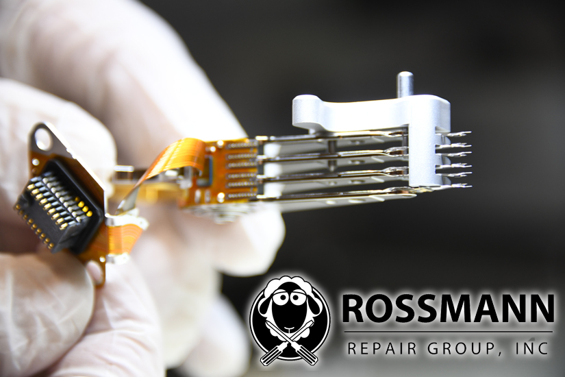

Head swaps run on a 0.02 micron ULPA-filtered laminar flow bench with a donor matched to the family, head map, and firmware revision; platter handling stays inside that bench from de-lid to image. Firmware faults are addressed through SA module access on the PC-3000 rather than mechanical work. Pricing tiers run $100–$2,000; under our no-data, no-recovery-fee policy, you pay nothing if the files cannot be read off.

Donor-matched head swap
A mechanical recovery procedure that replaces a failed head stack assembly with a compatible donor. The donor drive is verified before any swap against parameters including head map and head count, preamp silicon revision, firmware family and revision, platter density and tracks-per-inch geometry, serial range or site code, and ROM adaptives including microjog offsets. Driving patient heads with the wrong bias voltages programmed for a different preamp revision crashes them on contact.

Gloved hand holding a six-slider head stack assembly with the preamp flex circuit visible, inspected before donor matching for a head swap
Six-head stack inspection: every slider, preamp, and ramp checked before swap.

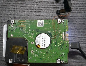

PCB board work with ROM transplant onto a matched donor. Firmware reflash and translator regeneration through terminal access. Adaptive parameter restoration via service area editing. Component-level soldering of shorted TVS diodes or burnt motor drivers using Hakko irons. Thermal mapping of PCB power-rail shorts with a FLIR camera. These qualify as "repair" in the technician sense; once the drive responds, we image the platters and retire the drive.

Component-level repair is board-level diagnostic work on the hard drive PCB: identifying the ROM chip, dumping it natively, reflowing a burnt motor controller IC, and replacing a shorted TVS diode. Traditional recovery shops outsource this work; we built our reputation doing it in-house.
Our component-level capability comes from hundreds of filmed board-repair videos recorded before we ever quoted a hard drive recovery job. The same microsoldering skill that fixes MacBook logic boards diagnoses an HDD PCB without guesswork.
If you searched "louis rossmann hard drive recovery" or "rossmann data recovery," the entity behind those queries is the same engineer who repairs MacBook logic boards on YouTube. The microsoldering work documented on that channel is the upstream skill that makes hard drive PCB diagnostics tractable rather than guesswork.
Most traditional recovery labs cannot do this in-house and ship the board out, swap a donor PCB blindly without ROM transfer, or quote firmware work they actually subcontract.
The bridge between the two disciplines is the hard drive PCB itself. Every modern Seagate, Western Digital, and Toshiba drive carries unique adaptive parameters in a ROM chip soldered to the board.
Recovery work on a dead PCB starts with the same tools that come out for a logic-board repair: a Hakko FM-2032 on an FM-203 or FX-951 base, an Atten 862 hot-air rework station, and a FLIR thermal camera to map a shorted power rail before any chip leaves the board.
HDD PCB failure modes we fix at the component level
Native ROM extraction, not blind PCB swap
A donor PCB without the original ROM will not spin the drive past calibration because the adaptives are unique to the head stack that left the factory with that board. On Seagate F3 architecture families like the 7200.11 and newer, we desolder the 8-pin SOIC ROM, dump it through a programmer, and write that image to the donor before the swap. On Western Digital Marvell-controller drives the ROM is embedded inside the MCU and cannot be read directly off a dead board, so the donor PCB is installed first and the ROM is reconstructed from Service Area modules read off the platters through PC-3000. Either way, the PC-3000 Portable III then verifies the family ID and resource module table once power is applied.
Adaptive parameter transplant after a power event
When the original PCB is intact but the SA module is corrupted, we use PC-3000 terminal access to rebuild the translator and rewrite the adaptive tables. On a Seagate F3 drive that means regenerating SysFile 28 (the primary translator) against the P-list and G-list to reconstruct the LBA-to-PBA map; on a Western Digital SMR drive it means regenerating Module 190 (the T2 translator) that controls shingled-zone mapping. A ROM-only transplant is insufficient because the adaptive zones in the service area are written during factory calibration and reflect the physical geometry of the specific head stack assembly. PC-3000 talks to the drive in terminal mode, reads what survives, and patches what does not.
TVS diode replacement after surge or reversed-polarity events
The 5V and 12V TVS diodes on a hard drive PCB are sacrificial. They short to ground when the rail spikes, which protects the controller and the motor driver IC but leaves the drive unable to power on. Replacement is straightforward board-level rework with the Hakko iron: confirm the short with a multimeter, lift the failed diode, install a matched part, verify the rail recovers under load. Most full-service recovery labs charge a board-work line item for this and send it out; we keep it inside the firmware tier.
Motor controller IC reflow when spindle commutation fails
A drive that refuses to spin up but draws current usually has a failed commutation stage in the SMOOTH-family motor controller IC. Bonded-wire failures inside the package reflow back into contact at low temperatures, which is enough to image the platters through PC-3000 once the drive comes ready. The Atten 862 hot-air station delivers a controlled profile; the FLIR thermal camera confirms we are not heating adjacent passives to their reflow point. This is recovery work, not a permanent fix.
PC-3000 SA terminal mode for corrupted translator
The translator is the firmware module that maps a logical block address to a physical sector on the platter. When it corrupts, the drive enumerates with the wrong capacity, with no model string, or hangs in a busy state.
We use the PC-3000 Portable III in terminal mode to load a known-good resource module table from the drive family database, rebuild the translator from the surviving G-list and P-list, and bring the drive ready long enough for the DeepSpar Disk Imager to clone the platters. The drive is then retired.

Shucked external drive PCB with thin wires soldered from the internal SATA test pads up to a SATA cable, bypassing the failing USB bridge board for imaging
External drive shucked: failing USB bridge bypassed, internal SATA wired to PC-3000.
External hard drives use the same 2.5-inch or 3.5-inch mechanisms as internal drives, housed inside a USB enclosure with a bridge board (ASMedia, JMicron, or proprietary chipsets). When a USB external drive fails, the problem is almost always the drive inside, not the enclosure. We remove the bare drive, connect it directly to our PC-3000 via SATA, and diagnose the actual failure: firmware corruption, head damage, or motor seizure.

WD Marvell Controllers: ROM Architecture
Western Digital drives (WD Blue WD10EZEX, WD Red WD40EFRX, WD Black, WD Purple) use Marvell controller ICs on the PCB. Unlike Seagate drives where the firmware ROM is a separate 8-pin serial flash chip that can be desoldered and read independently, many WD Marvell controllers store adaptive parameters and ROM data in the controller IC itself.
When a WD drive suffers a PCB failure (power surge, shorted TVS diode, blown motor driver), a simple board swap will not work. The replacement PCB has its own ROM data that does not match the patient drive's platter calibration.
On boards that have a separate 8-pin ROM chip (typically numbered 25Pxx or 25Qxx), we desolder the chip from the dead board and transfer it to the donor board.
On boards where the ROM is integrated into the Marvell controller, we use PC-3000's WD module to read the ROM from the service area of the platters (which requires at least a partially functional PCB) and write it to the replacement board.
WD My Passport and Elements external drives add another layer: hardware encryption. Even when the drive inside is a standard WD Blue or WD Green, the USB-SATA bridge board encrypts all data before it reaches the platters. Losing or damaging that bridge board means the encryption key is gone.
We preserve and transplant the original bridge board electronics whenever possible. If the bridge board is destroyed, recovery depends on whether the encryption implementation allows key extraction from the board's controller chip.

A compatible donor drive requires matching on parameters including model family, firmware revision, head count, manufacturing site, adaptive parameters, and preamplifier revision. Mismatching any one of them causes the donor heads to click on the patient drive, wasting the single mechanical attempt available before the platters degrade further. Head swaps are one-shot procedures; donor selection determines the outcome.
Head swaps are the most mechanically demanding recovery procedure. The donor drive is destroyed in the process, the patient drive gets one attempt, and the imaging window after installation is finite. Every variable in the matching and installation sequence affects whether data comes back.
Donor Selection Criteria
A compatible donor is not just the same model number. We match on the parameters below before committing a donor drive to a swap, and which of them are decisive depends on the exact drive:
  • Model family and firmware revision. A Seagate ST2000LM007 with firmware SBK2 will not accept heads from the same model running firmware SDM1. The firmware calibrates head fly height and write current to the specific head stack installed at the factory.
  • Head count and platter count. Manufacturers ship the same model number with different internal configurations depending on production run. A 2TB drive may use one platter with two heads or two platters with four heads. Installing a two-head stack into a four-head chassis leaves half the platters unreadable.
  • Manufacturing site and date code. Seagate drives manufactured in Wuxi (China) versus Korat (Thailand) can have different head stack assembly suppliers. The head geometry is nominally identical, but adaptive parameters written during factory calibration differ enough to cause read instability on marginal tracks.
  • Adaptive parameters. Each drive stores calibration data (fly height offsets, write current per head, and servo tuning values) in the system area of the platters and in the PCB ROM. On Western Digital drives with Marvell controllers, these parameters are partially stored in the controller IC itself. After a head swap, the new heads read the patient drive's adaptive parameters from the service area and attempt to operate with calibration data written for different physical heads. The closer the donor match, the smaller the gap between stored calibration and actual head behavior.
  • Preamplifier revision and micro-jog tolerance. The signal chain starts at the MR (Magneto-Resistive) read element on each slider: its resistance fluctuates in response to magnetic flux transitions on the platter surface. The preamplifier chip on the head stack assembly (manufactured by Texas Instruments or Broadcom, depending on family) pushes a constant bias current through the MR element & amplifies the resulting microvolt-level analog signal. That signal travels down the flex cable to the read channel IC on the PCB, where PRML equalization & Viterbi detection extract the digital bitstream. Donor and patient drives must share the same preamp vendor and revision. The HSA suspension (manufactured by Hutchinson Technology or Magnecomp) provides precise gram load to counteract the aerodynamic lift of the slider's Air Bearing Surface (ABS), & the gimbal flexure at the distal end provides pitch & roll stiffness for the slider to track the platter's microscopic warp. Even within the same model line, manufacturers switch between suspension suppliers, so donor & patient must match suspension geometry. Beyond the preamp, each head has a factory-calibrated MR Head Differential Micro-Jog value that defines the physical offset between the read and write elements on that specific slider. If the micro-jog values between donor and patient heads diverge outside a ~200 to 300 count tolerance, the drive will click on power-up because the read channel cannot lock onto the servo track. We check micro-jog compatibility in PC-3000's ROM editor before committing to the physical swap.
Pre-Swap Platter Inspection
Before removing the failed heads, we inspect the platters under our 0.02 µm ULPA-filtered clean bench. We look for three things: scoring (visible scratches from a head crash), particulate contamination (debris from degraded heads circulating inside the HDA), and stiction marks (areas where heads adhered to the platter surface on 2.5-inch drives).
If scoring is present, the damaged zones are mapped before the swap. Those zones will produce read errors regardless of how good the donor heads are, and the imaging strategy must account for them from the first sector. If contamination is visible, the platters are cleaned before installing donor heads. Inserting new heads into a contaminated HDA will destroy the donor stack within minutes.
Removing and installing the head stack assembly requires separating the heads from each other without letting them contact platter surfaces. We use duralumin head combs, CNC-machined to sub-0.01mm tolerances, sized specifically for each drive family. Duralumin (an aluminum-copper alloy) holds dimensional accuracy under the mechanical stress of separating spring-loaded heads.
Plastic head separation tools, common in consumer data recovery kits, suffer from plastic deformation: they flex under load, allow heads to shift during extraction, and can cause the slider to contact and score the platter during what should be a non-contact procedure.

Clean-bench head swaps
Clean-Bench Head Swaps: ULPA Filtration, Donor Matching, and HSA Azimuth Alignment
A clean-bench head swap replaces a failed head stack assembly inside a 0.02 micron ULPA-filtered laminar flow bench. Donor selection requires matching the HSA by model family, firmware revision, and preamp silicon revision. Micro-jog servo lock tolerance sits at approximately plus or minus 300 points; a donor outside that window produces click-on-spin-up and platter scoring.
ULPA filtration at 0.02 microns captures particles down to 20 nanometers. Modern read/write heads fly 1 to 5 nanometers above the platter surface, so any particle that size causes a head crash on spin-up. A standard HEPA filter passes particles down to 300 nanometers, which exceeds the flying height and introduces unnecessary contact risk on an open chassis.
Head combs keep each slider off platter media during extraction and seating. On helium-sealed designs, the head comb geometry must match the platter spacing exactly; a 9-platter Seagate Exos and a 7-platter WD Ultrastar use different spacings and therefore different comb fixtures. Azimuth alignment after installation is confirmed via PC-3000: the firmware reads per-head servo lock status and flags any head whose micro-jog value falls outside the tolerance window before imaging begins.
Technical depth on the procedure: what a head swap involves, step by step | cleanrooms vs laminar flow benches: filtration specifications | how donor drives are matched by family, firmware, and revision

SMART modules are a separate problem. When a SMART log overflows or its checksum fails, some firmware platforms refuse to complete initialization and drop the drive into a busy state even though the user data is intact. The repair is to clear the corrupted SMART log in a Service Area RAM copy, patch the background-process control flags so the firmware does not immediately rewrite a fresh corrupted log, and proceed with imaging. The patient SMART data is preserved as a dump in the case file so a post-recovery report can still show the failing attribute counts that explain why the drive failed in the first place.
Helium Drive Firmware Repair Stays In-House
Enterprise helium-sealed drives such as the Toshiba MG-series and equivalent high-capacity platforms from other vendors are hermetically filled with helium to reduce aerodynamic drag on the platters. Translator corruption, G-list overflow, and ROM faults on these drives are repaired with the PC-3000 Portable III without touching the hermetic seal. When a helium drive also has mechanical failure that requires a head swap, the drive is opened under the 0.02 micron ULPA-filtered clean bench at the Austin lab, then resealed and purged and refilled with helium through a calibrated manifold before the platters are ever spun, with helium refill, platter cleaning, and seal reassembly. Helium head swap, platter cleaning, and high-purity helium refill are performed entirely in-house at the Austin lab.
Standard tier pricing applies to firmware-only repairs that do not require the clean bench. Mechanical work on helium drives uses the helium tier from $200–$5,000+, with +$100 rush fee to move to the front of the queue available for cases that need to skip the standard queue. Non-helium mechanical recoveries fall under the HDD tier published at $100–$2,000. No diagnostic fee applies in either case; if the data is not recovered, there is no recovery fee.
PCB & Microsoldering Bridge

A dead HDD PCB usually starts with a shorted TVS diode on the 5V or 12V rail, a cracked main controller, or a burned spindle driver. Those are board-repair faults, not data-recovery faults; they get isolated under the stereo microscope before any firmware work begins. When the controller has to be bypassed, the SOIC-8 SPI flash that holds the per-head adaptive set is desoldered with the Atten 862 at 320-350 °C, read in an external programmer, & either reflowed onto a matched donor PCB with the Hakko FM-2032 or held as the patient's ROM of record for kernel-mode SA work.
A straight donor PCB swap fails on every modern hard drive, even when the silkscreen board number matches (for example WD 2060-771961 against 2060-800067, or Seagate F3 families with identical main controllers). The reason is that the adaptive parameters, per-head preamp gain, channel coefficients, microjog offsets, & thermal fly-height control values, are unique to the head stack that left the factory in that chassis. Modern PMR read/write heads hold an active magnetic spacing of about 1 to 2 nanometers over a few nanometers of baseline clearance; if the donor PCB drives the patient heads with the wrong calibration, the heads either fail to find servo or scrape the recording surface. The actual procedure is ROM transfer (or a ROYL kernel-mode SA backup when the chip is cracked) first, donor PCB second, then translator work on a PC-3000.
Even with the ROM in the right place, a healthy PCB only buys SATA identification. A drive with a corrupted translator still reports 0-byte capacity, a factory alias, or hangs in BSY because the firmware can't map LBA requests to physical sectors. From there, the PC-3000 Express terminal is the bench: SA module backup, loader (LDR) upload into controller RAM, translator regeneration, then virtual-translator imaging of the user area. The procedural detail of that workflow is documented in our PC-3000 procedure reference.
Most general-purpose recovery shops treat the PCB tier as a parts-swap quick fix & move on when it fails. On a post-2008 hard drive, the actual job is board-repair work followed by firmware reconstruction. PCB diagnostics, ROM extraction, & SA / translator rebuilds all fall in our Firmware Repair tier at $600–$900 (CMR drive: $600. SMR drive: $900.) with 3-6 weeks turnaround, performed at the same Austin bench that runs the lab's MacBook logic-board work.

Why This Extends the Window Before a Head Swap
A donor head swap is a last-resort procedure on our bench because it is expensive for the customer and carries real risk of platter contact during the transfer. Pricing for a head swap sits at the $1,200–$1,500 tier on air drives and climbs on helium models where the helium refill is required after the swap. If the patient still has electrically viable heads, the correct move is to image as much data as possible with those heads first, then fall back to a swap only for the remaining unrecovered LBAs.
DeepSpar multi-pass imaging is what makes that triage possible. Because the firmware is never allowed to enter a prolonged retry loop, the FIR equalizer keeps its service-area-calibrated tap weights. Because read-look-ahead and auto-relocation are disabled, the drive does not write to the service area during imaging and does not add new G-list entries that would later need to be cleared. Because the head-map instructs DeepSpar to use healthy heads first, the weak head is only engaged for the sectors that no other head can cover, and the targeted retry pass on the weak head extracts whatever the Viterbi decoder can still resolve before a swap is considered.
When the weak-head pass stops producing new sectors, we move to a donor head swap on the 0.02 micron ULPA-filtered clean bench and reimage only the LBAs mapped to that head. That workflow needs DeepSpar running in coordination with PC-3000 against a head map built from the service area. It is the reason a drive that would otherwise go straight to a mechanical quote can sometimes finish imaging without ever being opened.

PC-3000 SA firmware repair
PC-3000 SA Firmware Repair: Module 190 Translator Rebuild, ROM Extraction, and Seagate F3 Terminal Access
PC-3000 SA firmware repair rebuilds the translator module that maps logical block addresses to physical platter sectors. On WD SMR drives, Module 190 controls the T2 translator architecture that manages shingled-zone mapping. On Seagate F3 drives, the equivalent translator rebuild runs through direct PCB TX/RX pad access at 38400 baud, where the Media Cache Management Table governs whether that rebuild is survivable at all.
ROM extraction transfers the 8-pin SPI flash ROM from the patient PCB to a family-matched donor before any power is applied. That ROM holds microjog offsets, thermal fly-height values, and per-head channel tuning written at the factory. A donor board without that ROM drives the heads with wrong calibration and produces immediate clicking. On WD Marvell architectures where the ROM is embedded in the MCU, PC-3000 reads the adaptive data from surviving SA modules on the platters and reconstructs the parameters before the heads ever spin.
SA defect lists, the G-list and P-list, map bad sectors so the drive routes read and write operations around them. When a power loss corrupts these lists, the drive enters a busy or not-ready state because the translator cannot resolve LBA-to-PBA mappings. PC-3000 Portable III loads a known-good resource module table from the drive family database, regenerates the translator against the surviving defect map, and brings the drive ready for DeepSpar imaging.
More detail on each layer: what PC-3000 actually does, module by module | how hard drive firmware works: SA, ROM, translator, and adaptive parameters | hard drive firmware corruption: symptoms, causes, and recovery path | WD SMR translator failure: Module 190 and T2 architecture

WD Ultrastar 8TB
Head swap recovery
If read/write heads fail on an enterprise HDD, donor matching checks firmware revision, head map, preamp family, and adaptives before the head stack is transferred.
$1,200–$1,500
Watch head swap case →

Why a PCB swap alone fails: adaptive parameters and ROM extraction
The bootstrap ROM on a modern hard drive PCB holds more than the initial loader. It also stores adaptive parameters calibrated for the exact head stack inside that specific drive at the factory. The parameters tune the PRML read channel for each head individually and include:
  • Preamplifier gain trim per read element
  • Thermal Fly-height Control voltages per head
  • Voice coil motor servo timing offsets
  • Microjog corrections for off-track positioning
  • FIR equalizer tap coefficients
Modern high-capacity drives use Noise-Predictive Maximum Likelihood read channels, which are exquisitely sensitive to these per-head calibration values. Soldering a donor PCB onto the drive without first transferring the original ROM data pushes the wrong write currents and the wrong fly-height bias into the preamplifier on the head stack. At sub-nanometer head-to-platter spacing the mismatch either kills the preamp on first spin-up or causes the heads to contact the platter surface and start scoring the magnetic coating. The correct procedure is to either desolder the original SPI flash ROM and reflow it onto the donor, or extract the ROM contents on a programmer and write them to the donor's blank ROM, then validate the resulting adaptives on the PC-3000 Portable III before powering the drive against the live head stack. This pattern of failure is the leading cause of permanent data loss after well-meaning DIY attempts to recover hard drive firmware corruption with a parts-bin donor board.

Why does a head swap require an exact donor match instead of any same-model drive?
Each hard drive is factory-calibrated to the specific head stack assembly installed during manufacturing. The drive writes adaptive parameters (fly height offsets, write current per head, servo tuning) to its system area. A donor drive with the same model number but a different firmware revision, head count, platter count, or manufacturing site will have different calibration data. After a head swap, the donor heads read the patient drive's stored parameters and attempt to operate with calibration values written for a different physical head stack. A close match minimizes this calibration gap. A poor match causes read instability, especially on high-density tracks near the inner diameter where tolerances are tightest. We match on parameters including model family, firmware revision, head count, platter count, and manufacturing site code; which ones have to line up depends on the exact drive.
Can I perform a hard drive head swap at home?
No. A head swap requires a particle-free environment, manufacturer-specific ESD-safe head combs, and PC-3000 firmware tools. Modern read/write heads fly 3 to 5 nanometers above the platter surface. Opening the drive outside a ULPA-filtered laminar flow bench introduces airborne particles that act as microscopic abrasives, destroying the heads and gouging the platters when the drive spins up. Even if the physical swap succeeds, the drive's firmware stores adaptive parameters calibrated to the original heads. Without modifying those parameters via PC-3000, the donor heads will mistrack and the drive will click or mark good sectors as bad. Consumer tools and YouTube tutorials cannot replicate the firmware-level calibration step.
