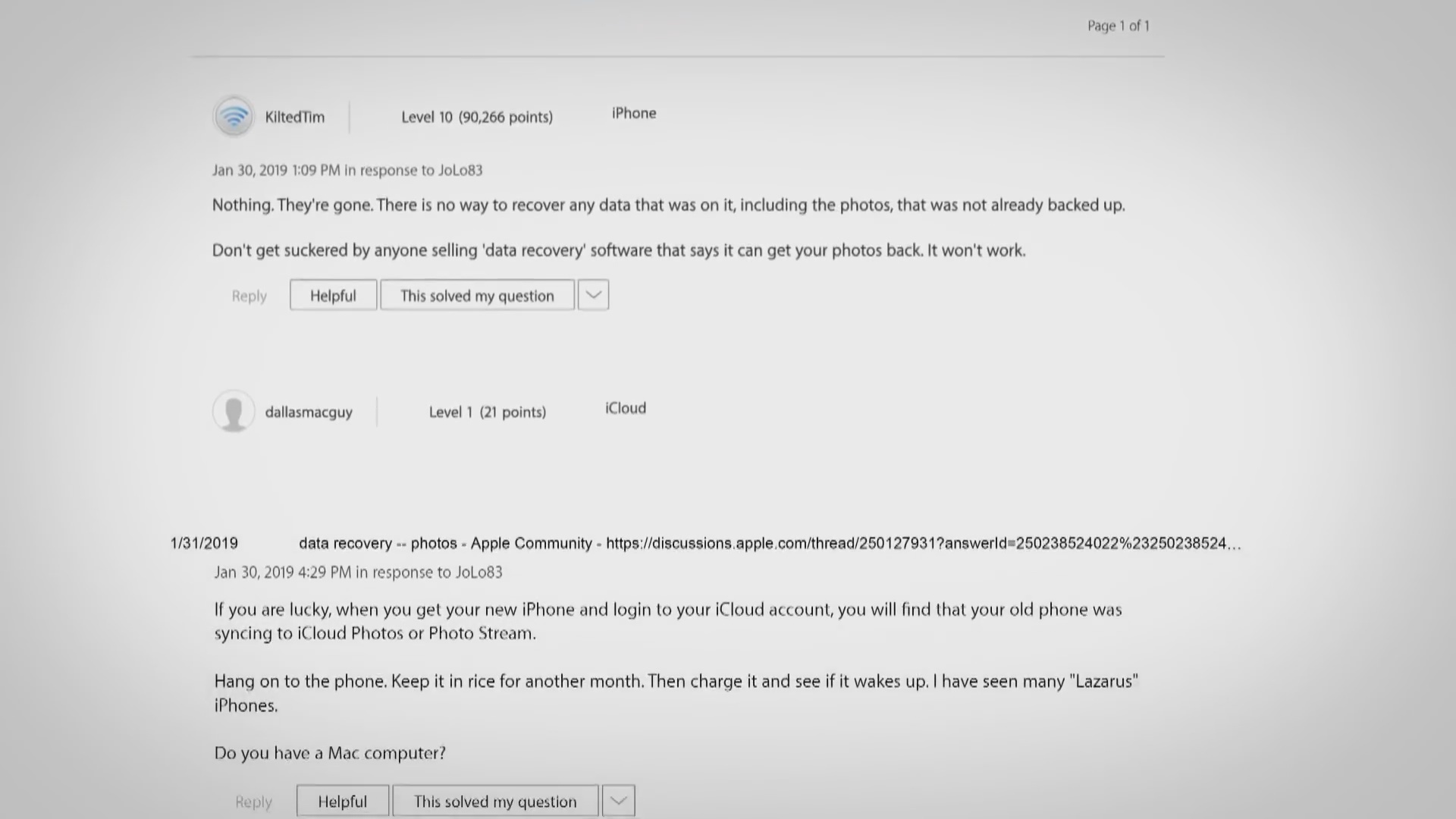

Data Recovery Software Will Not Help a Dead iPhone
Software tools like Dr.Fone, UltData, and PhoneRescue require the iPhone to be powered on and communicating over USB. If your phone is dead, water-damaged, or not detected by your computer, no software can reach the encrypted storage. Board-level microsoldering is the only path forward.
The reason is electrical. When Tristar (iPhone 5 through 7) or Hydra (iPhone 8 through 14) fails, the phone never finishes the USB handshake, so the computer never sees a device for software to scan.
A short to ground on the main system power rail has the same effect from the other direction: the PMIC refuses to bring the board up, and nothing boots to be scanned. A drop or a rushed third-party repair can instead fatigue the BGA solder spheres under the CPU or the NAND, severing the bus between the processor and the storage it has to decrypt through.
Software recovery tools like Dr.Fone, UltData, and PhoneRescue only work on a phone that still works. They scan iTunes or iCloud backups, or communicate with a working phone over USB.
If your iPhone is dead or won't turn on, no software on earth can reach the data.
