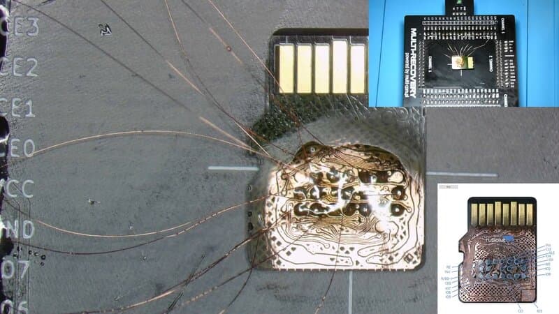

Monolithic microSD card wired to PC-3000 Flash spider board for direct NAND extraction
Spider board adapter with needle probes contacting exposed NAND test points on a monolithic microSD card. Each needle maps to a specific flash signal line.

Direct Wire Soldering
The older method: solder 30 AWG (or finer) jumper wires directly onto each test point, then connect each wire to the corresponding pin on a PC-3000 Flash circuit board adapter. This was the standard approach before spider boards existed and is still used when test points are too deeply recessed for needle contact.
Wire soldering requires a micro-tipped iron, flux, and magnification. Each solder joint must bridge a pad that may be smaller than 0.1 mm across. A solder bridge between adjacent pads creates a short that can corrupt the read or damage the die. Flux residue can also cause intermittent signal issues if not cleaned.
+Works on deeply recessed pads where needles cannot reach
+Lower equipment cost (standard soldering station)
-Heat risk to the NAND die from soldering iron
-One-shot: lifting a pad from excess heat destroys that signal path
-Solder bridges between adjacent pads risk shorts
Spider board needles contacting exposed NAND test points on a microSD card connected to PC-3000 Flash
Spider board wiring from our lab: each needle contacts a single test point on the monolithic die. This particular card required 17 needle placements to capture all data bus, control, and power signals.
