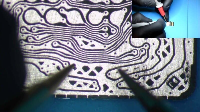

The determining question is where the fault sits: in the path from the external contacts to the controller, or in the controller itself. A break in the contact path is repairable without ever opening the package. A dead controller is not, & forces the extraction path.
Most cracked, snapped, & scratched-contact microSD cards fail because the thin copper traces between the gold pads & the internal die get severed, not because the silicon died. The controller & NAND are intact; they just can't talk to a card reader anymore because the wire between them is cut.
On those cards the least invasive fix is a jumper: under a stereomicroscope, we bridge the severed trace with hair-thin wire on a Hakko FM-2032, the controller powers up normally, & the card enumerates & copies off like nothing happened. No epoxy comes off.

Watch a Cracked MicroSD Trace Repair & NAND Read
This is the decision path on the bench. A cracked 128 GB SanDisk microSD comes in with damaged contacts; the walkthrough covers repairing the severed trace, then reading the NAND directly when that's what the card needs. It's the same fork every physically damaged monolith presents: fix the path to the controller, or read the NAND without it.
The full recovery runs about 75 minutes end to end, filmed in one take at the lab. It shows the microsoldering, the pad work, & the raw read that a written page can only summarize.
